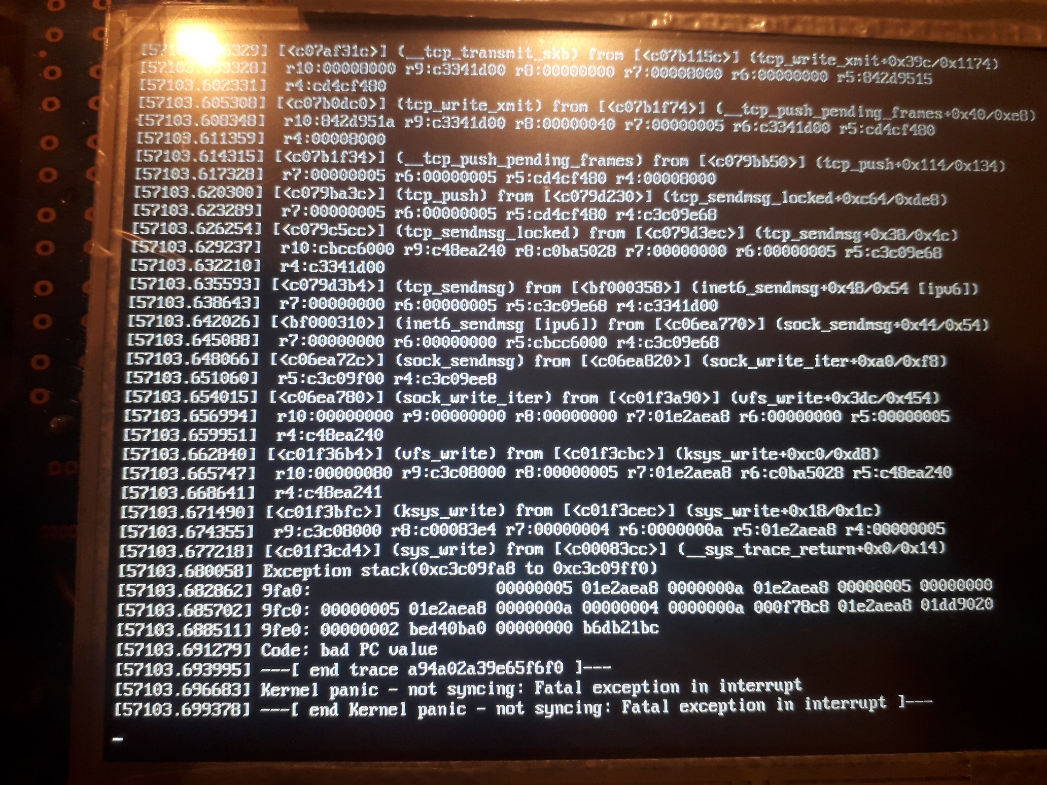

I now attached a screen to view additional error messages after the crash.
This is what I got.
This looks different to the error messages in the log files.
Do you have any ideas, what could be the reason for the crash?
This is a kernel panic. Could be data corruption. MichaIng what do you think?
This is with cron still disabled? A fsck would not hurt at least, and upgrading/reinstalling the kernel afterwards:

fsck did find some errors - let’s see if this helps.
Cron jobs were enabled during the last crash. I checked before to disable cron, but it did not change anything.
this seens to work - so it was due to a file system problem.
