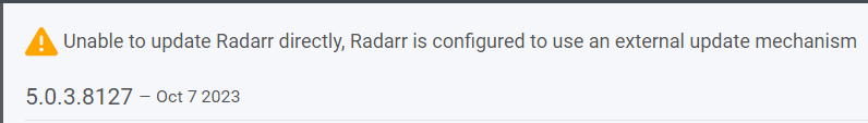

I used to be able to update Radarr from the UI manually until version 4.7.5.7809.
When I try to update from the UI, I get this message:
Please advise, thanks.

Thanks for your reply. I went ahead and tried this and still get the same behavior.
But you are on latest version available. What version you are looking for? Radarr seems to update automatically.
I’m trying to update to 5.0.3.8127. I’m currently on 4.7.5.7809. For some reason when this newest update came available, that error message popped up. 4.7.5.7809 and prior, I had no issues updating.

I found a bug report at Radarr GitHub. It seems an issue with Radarr believing it’s running as Docker container Radarr thinks it's running in docker when it isn't, and disables updates · Issue #9247 · Radarr/Radarr · GitHub
Solution is to update manually this time.

Thank you for providing the detailed instructions to do this, appreciated. This worked as expected.
