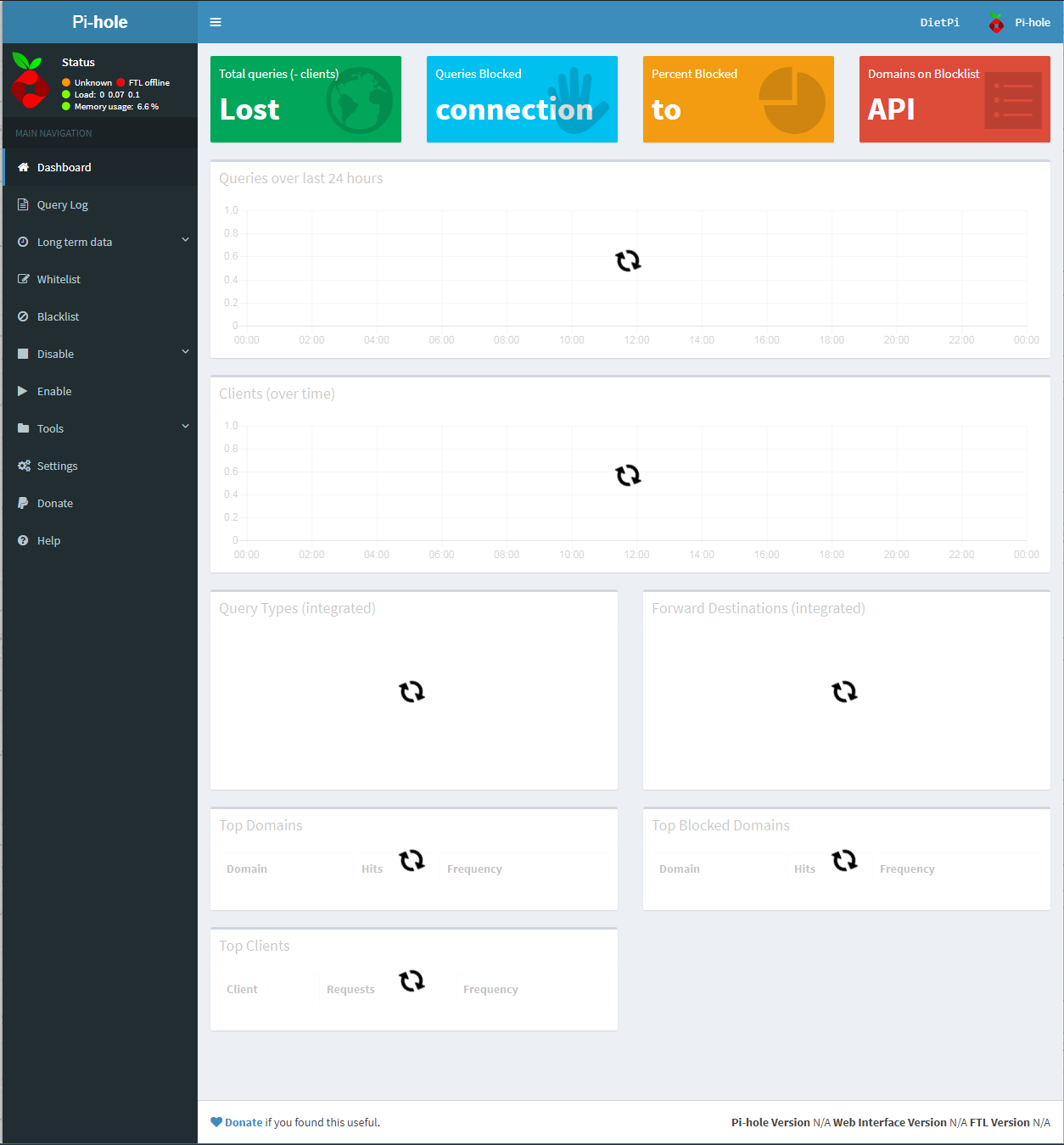

Purchased RPi3 & ODROID-XU4Q, downloaded proper images for them, easy install of DietPi.
Installed PiHole on both. Setup was simple, verified “Ethernet Network Options” setting were correct - Static IP, Mask, Gateway, DNS , however, when I head to /pihole I get the following (pic). Surprise it did not even ask me to login.
 ![LostConnectionToAPI.png](https://dietpi.com/forum/uploads/default/original/1X/6b89d31ae2087b5a4220270f305e7c851f5c3ec0.png)

Yes, sorry this happens with last version:
> Pi-hole Version v3.2 - Web Interface Version v3.2 - FTL Version vDev-437af07
> [@Pihole installation works only after 2 installs](https://dietpi.com/forum/t/pihole-installation-works-only-after-2-installs/1568/3):
> Yes correct, depending on device you used. This happen form time to time after putting a fresh image on sd card, since DietPi use the default PiHole install methode (install.sh) and not DietPi own PiHole repository any more. Installation breaks in the middle, without a message and you are back on cmd line. If this happen, you will notice, there is no pihole web password notification at the end of installaton process. But no big deal, second installation works. For me, NanoPi Neo, Orange…
uninstall and after this install via dietpi-software a secound time.
And please heck:
```plaintext
:~# dietpi-services status
 DietPi-Services
 Mode: status
 Please wait...
 [Ok] cron active (running) since Fri 2017-12-08 02:46:28 CET; 22h ago
 [Ok] lighttpd active (running) since Fri 2017-12-08 03:02:46 CET; 21h ago
 [Ok] php5-fpm active (running) since Fri 2017-12-08 02:46:50 CET; 22h ago
 [Ok] dnsmasq active (running) since Sat 2017-12-09 00:17:05 CET; 37min ago
 [Ok] pihole-FTL active (exited) since Sat 2017-12-09 00:17:06 CET; 37min ago
```plaintext
:~# pihole status
  [✓] DNS service is running
  [✓] Pi-hole blocking is Enabled
```plaintext
:~# pihole -v
  Pi-hole version is v3.2 (Latest: v3.2)
  AdminLTE version is v3.2 (Latest: v3.2)
  FTL version is vDev-437af07 (Latest: v2.12)

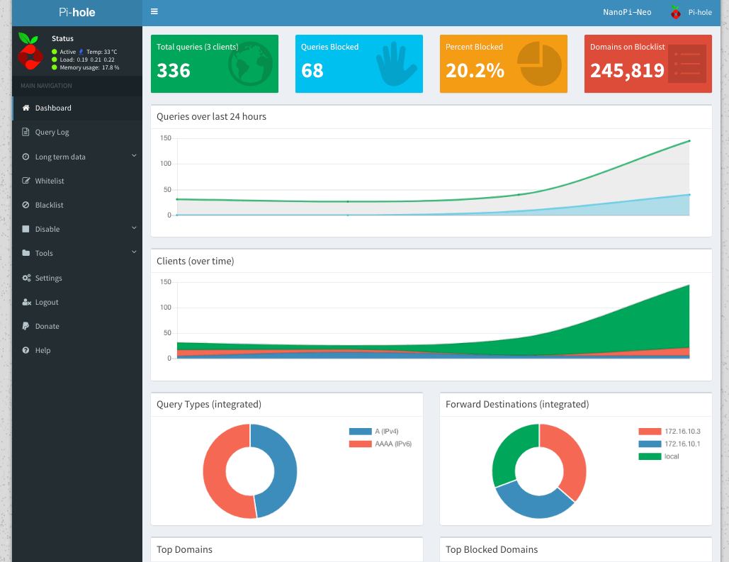

 ![171209-0001.gif](https://dietpi.com/forum/uploads/default/original/1X/80638d97b34a8cf118a869baccfd19971f8b6639.gif)

> [@k-plan](#):
You mentioned a while back, issue with user exiting the PiHole setup, pre-completion? Would that cause this?
We should probably fix that with a loop 🙂

Confirmed with XU4, ticket:
[https://github.com/Fourdee/DietPi/issues/1282](https://github.com/Fourdee/DietPi/issues/1282)
