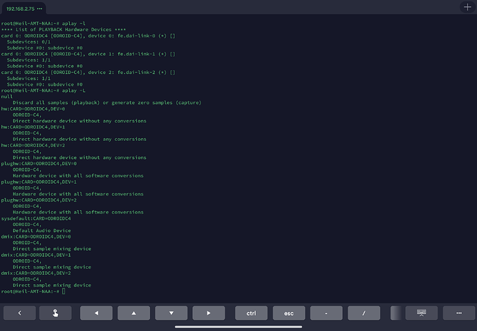

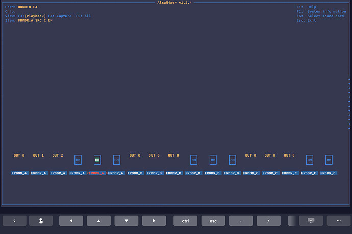

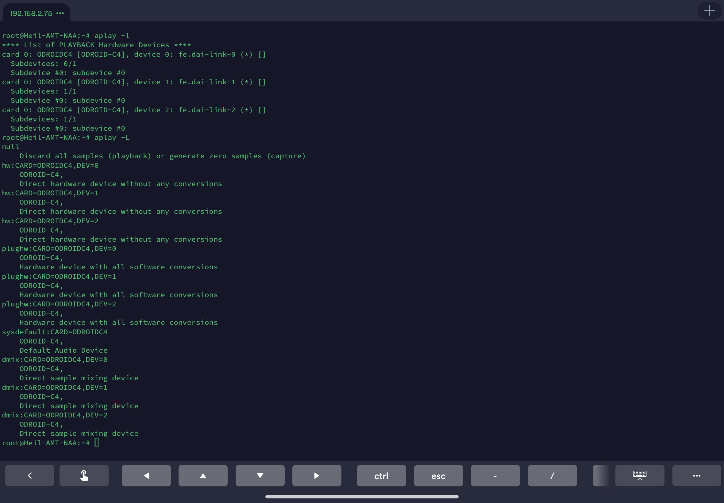

Here are some screenshots below.
Any tips what this means?

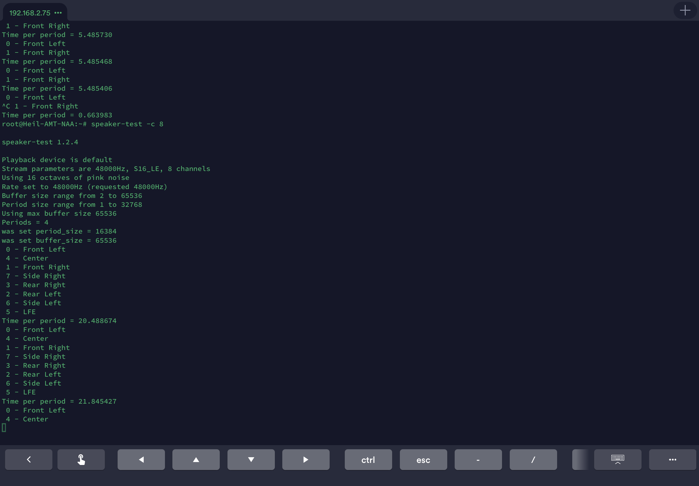

See 8 channel speaker test below, It runs but AVR only shows stereo and sound is only from ch1 and ch2 speakers. Nothing out of the other 6 speakers
