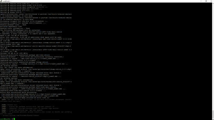

Hi.
I tried reinstall my odroid DietPi to latest versien from 0.
Ticked Kodi, FTP, Transmission to install.
i get this error and cant pass by. please help

Hi Marg,
Replicated, looks like you found a bug :slight_smile:. You can track progress here: https://github.com/Fourdee/DietPi/issues/617. Will let you know when its resolved.

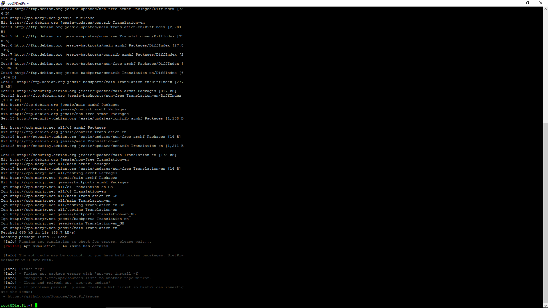

I don’t know if its connected but , when i tried to go forward withouth Kodi…
i get these :frowning:
Hi Marg,
Unfortunately, it appears the issue is with the libump-odroid and mali450-odroid packages. This is outside DietPi’s hands at the moment as the packages appear to be “broken”, they are maintained by Meveric.
I’ll send Meveric a message and get back to you when he replies: http://forum.odroid.com/viewtopic.php?f=114&t=17569&p=169386#p169386
