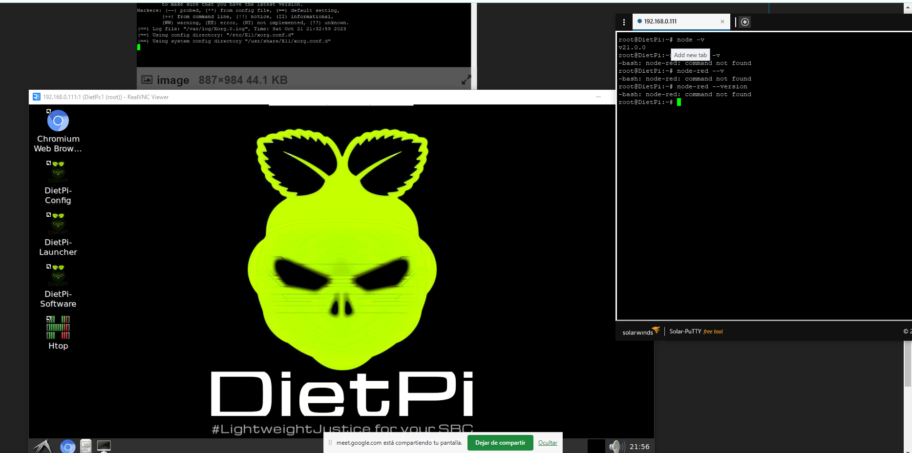

yes, im using realvnc
this is on solar putty:
As stated above already, there is absolutely no need to use startx. It has no influence into VNC. By default DietPi will start a virtual VNC session on boot at screen :1. Means, you need to add screen number to your IP address within RealVNC client: like 192.168.0.111:1. See our online docs Remote Desktop Access Software Options - DietPi.com Docs
You are a genius!!!
thanks a lot!!!
i’ve simply added :1 in realvnc and voila!
Thanks!
