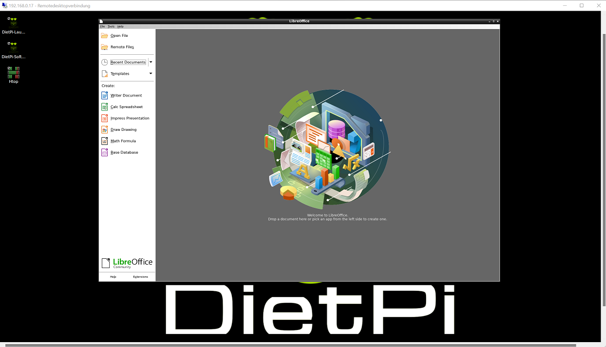

sorry. I could not answer before. I forgot to mention that I was testing on a virtual desktop with tigervnc. With Debian 10 I was using realvnc in “shared desktop” mode (I think it came by default because I don’t remember setting it up). I have been able to verify that in a virtual desktop some applications do not work (for example libreoffice among others). I have installed realvnc and configured shared desktop mode and I can now run any graphical application remotely. thank you very much!!!
hmm that seems to be a challenge using VNC. Because if I switch to XRDP, no shared desktop mode is needed.
I have been trying different vnc servers and I was able to fix this issue by installing TIGHTVNCSERVER . Now I can start a virtual desktop and handle any application. Is there any difference between Tigervnc or Tightvnc in terms of security or performance? Thank you very much again
