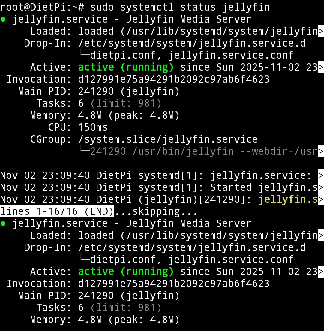

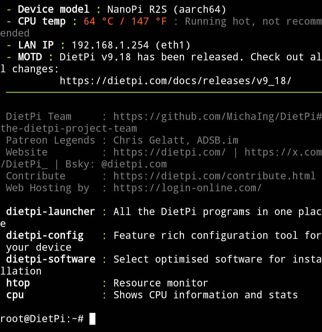

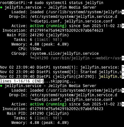

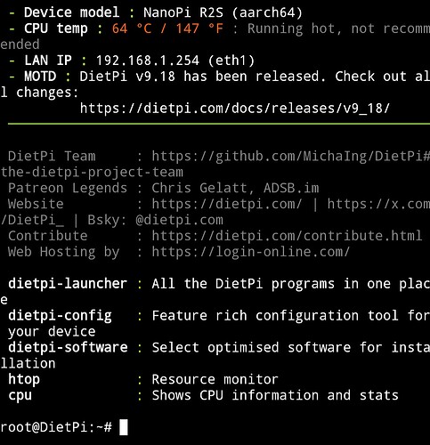

I have followed the instructions, but I can’t access Jellyfin in a web browser with port 8097 and ufw allows 8097
Did you check if the service is running?
service running
Btw there is no need to do screen shots, you should be able to copy everything from ssh terminal directly.
