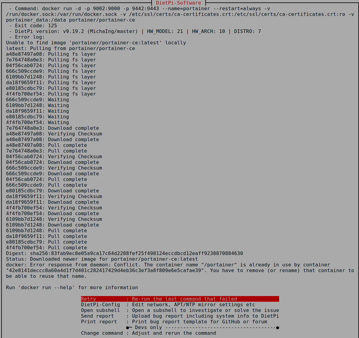

I followed the release notes to do a reinstall as instructed via dietpi-software reinstall.
This is what resulted, please advise:
* Command: docker run -d -p 9002:9000 -p 9442:9443 --name=portainer
  │ --restart=always -v /run/docker.sock:/var/run/docker.sock -v
  │ /etc/ssl/certs/ca-certificates.crt:/etc/ssl/certs/ca-certificates.crt:ro -v
  │ portainer_data:/data portainer/portainer-ce
  │  - Exit code: 125
  │  - DietPi version: v9.19.2 (MichaIng/master) | HW_MODEL: 21 | HW_ARCH: 10 |
  │ DISTRO: 7
  │  - Error log:
  │ Unable to find image ‘portainer/portainer-ce:latest’ locally
  │ latest: Pulling from portainer/portainer-ce
  │ 22d4f45bf667: Already exists
  │ 089b96337e3d: Already exists
  │ c551c6af3241: Already exists
  │ 9f7772ceb88a: Pulling fs layer
  │ d35c85f36345: Pulling fs layer
  │ f3e139b9cd66: Pulling fs layer
  │ 2d896f38a01e: Pulling fs layer
  │ 4f4fb700ef54: Pulling fs layer
  │ 2d896f38a01e: Waiting
  │ 4f4fb700ef54: Waiting
  │ 9f7772ceb88a: Verifying Checksum

The container already exists. Can you show
docker container ps
42e8141deccc   portainer/portainer-ee:latest              “/portainer”             2 weeks ago     Up 2 hours             8000/tcp, 9443/tcp, 0.0.0.0:9002->9000/tcp, \[::\]:9002->9000/tcp   portainer
You are running Portainer EE (BE) while we expect CE version. Pls drop container manually and try again.
