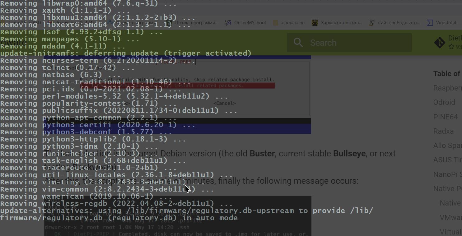

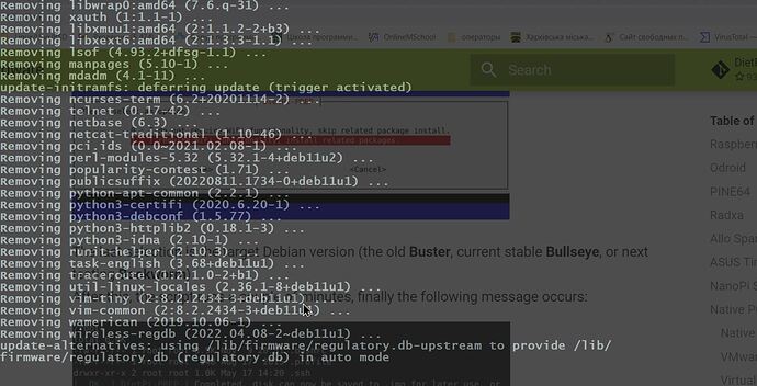

DietPi script remove mdadm package during preparation…

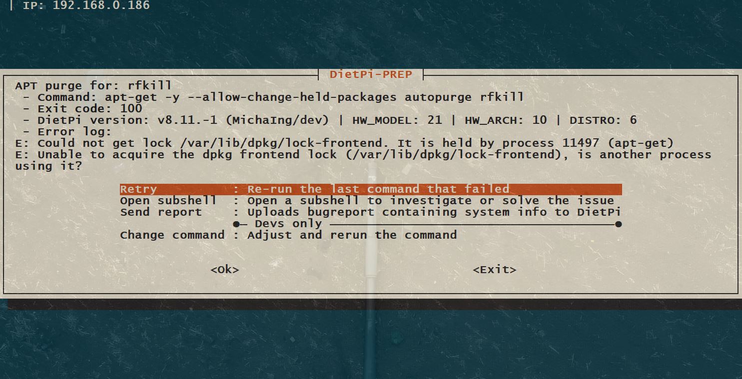

DietPi script remove rfkill package with error
this is useful package for wifi -

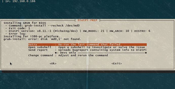

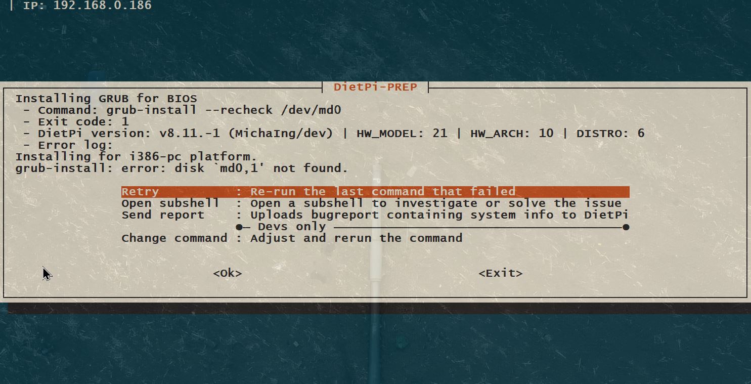

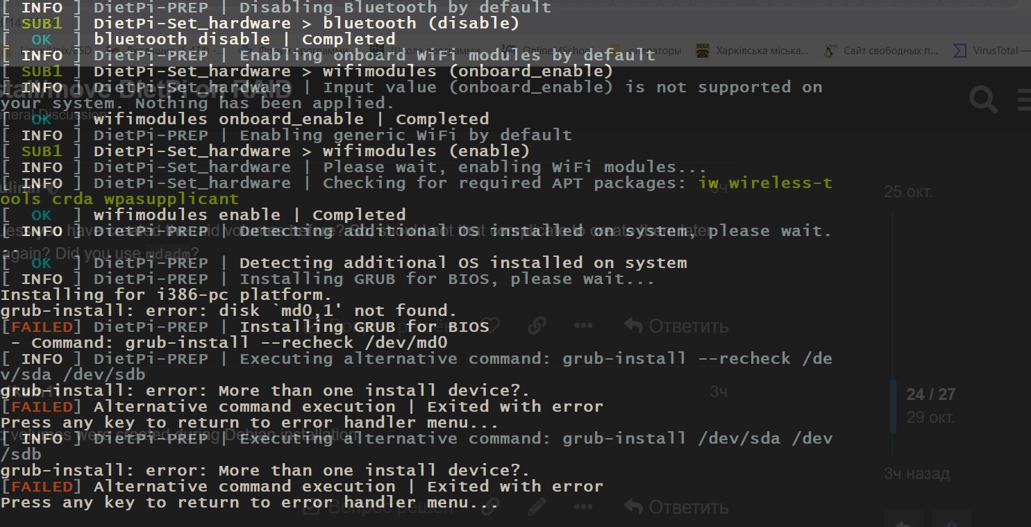

And at last, script stuck during install grub to /dev/md0
changing command to “grub-install /dev/sda /dev/sdb” not working
To be continue…

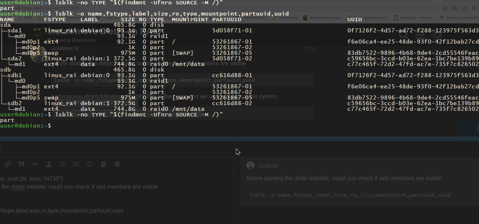

before starting the dietpi installer, could you check if raid members are visible
and can you share following as well? This is the command we use to detect a raid system
lsblk -no TYPE "$(findmnt -Ufnro SOURCE -M /)"
ok losing the mdadm package should be fine as we check if RootFS is located on a raid disk. If not, we continue to purge it as it can be installed again once install competed.
I guess you need to complete the setup on one of the disks sda or sdb first. Not sure if it is possible to install grub on 2 disks in parallel.
