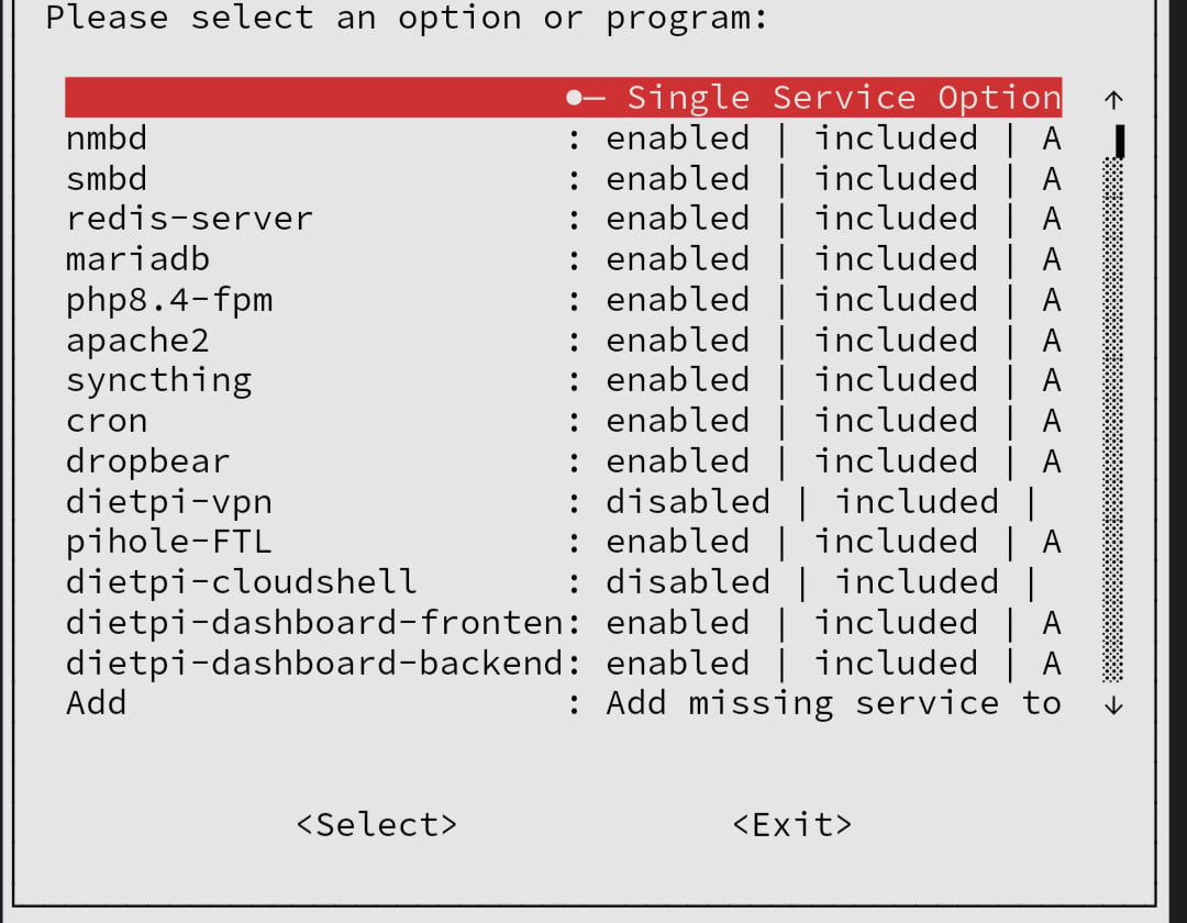

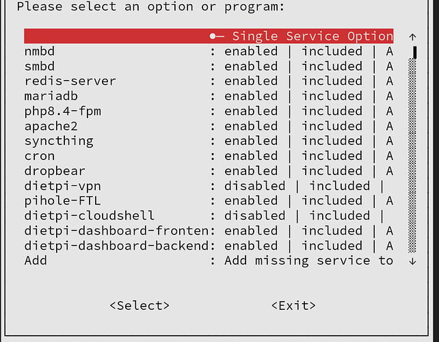

Is there anything I can use to find out what I don’t need anymore? I feel like there are too many services running.
I only need Pihole, Nextcloud, SMB, Dashboard, and Syncthing.
Nextcloud is not an own app. It’s a web server application. It is based on Redis, MariaDB, PHP and a web server (in your case Apache).
Ok, and how can I now check whether all services are really needed in the system?
All the services on your screen shot are needed
