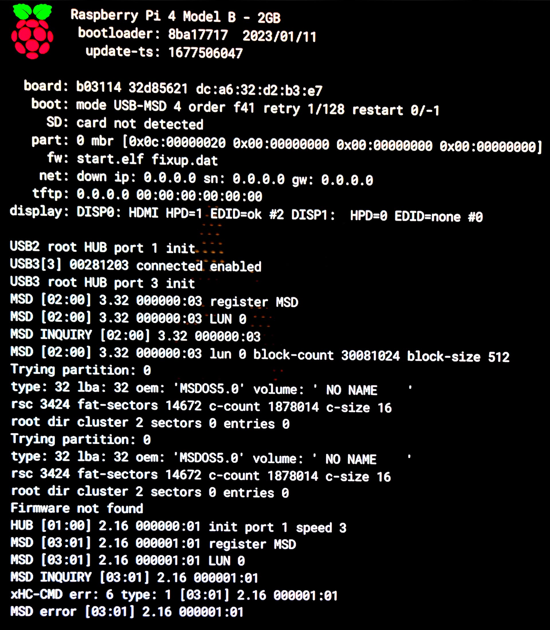

just flashed dietpi on a ssd, i get a Firmware not found error on boot
can you share the detailed error message? Maybe you can do a screen shot.
Looks like USB boot would need to be in enable first. But this would require to boot of SD card.
That’s kinda strange, I already had enable USB boot, cause recently I was using an usb stick instead of a sd
In this case you should be able to boot of SSD as well. How is the SSD powered? Did you tried different USB ports or another USB cable? Maybe try a powered USB hub.
i’ve double checked boot order, and it’s fine on BOOT_ORDER=0xf41
i’m using this nvme enclosure, i’ve tried both usb 3.0 ports but same result
edit: solved, the ssd must be partitioned in FAT32
Did you flashed a new image directly to your SSD? Usually this should create 2 partition. BootFS using vfat and RootFS using ext4
I’ve formatted the whole drive in FAT32, then flashed the image with Balena Etcher
Usually this is not needed as the whole disk will be overwritten by the image anyhow.
