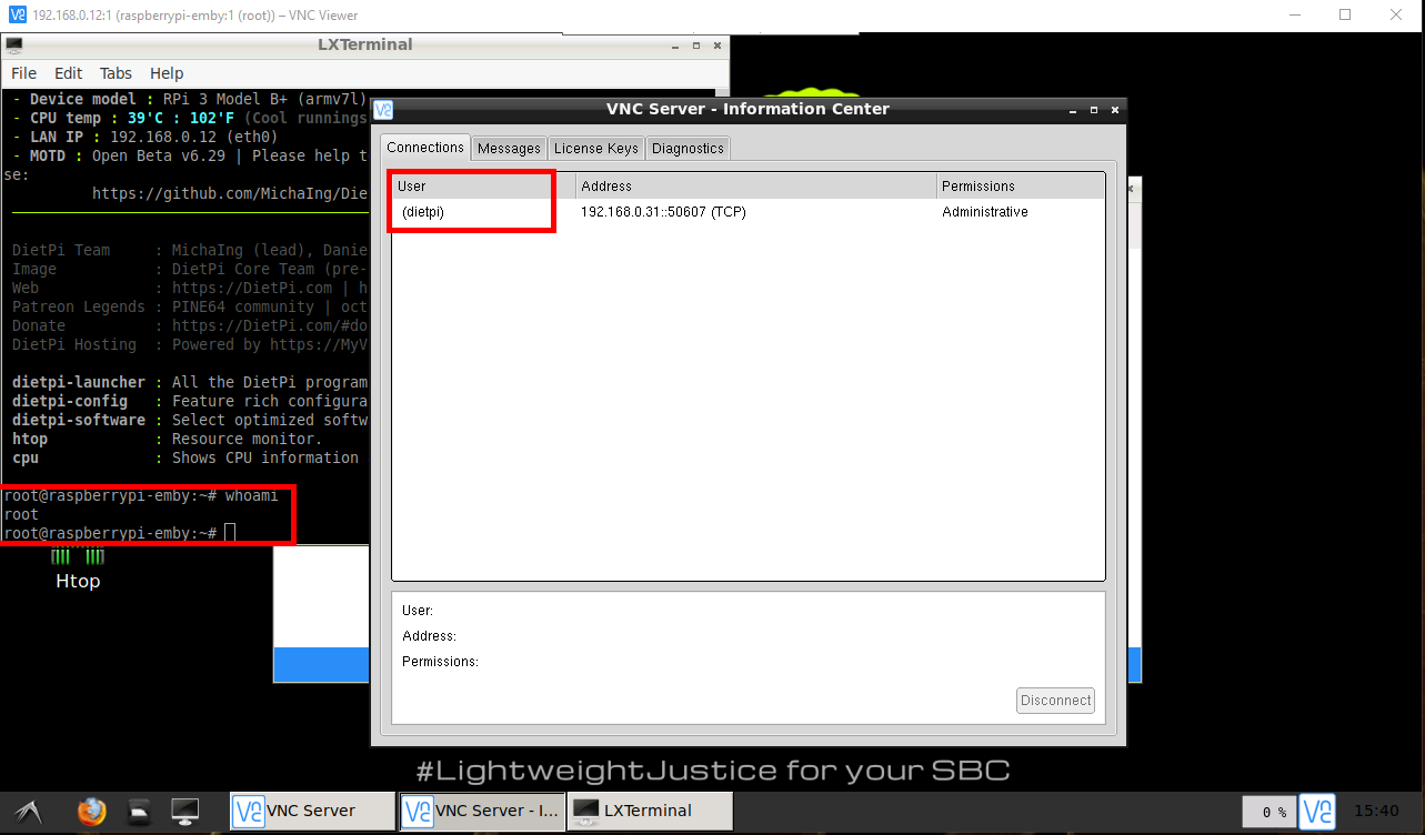

I’m able to login as user dietpi without issues, however inside VNC i’m user root. I guess this happen because the VNC session was started as root. See picture attached.
  1. On the VNC Server Information, you see that I’m login as dietpi
  2. On the LXTermianl you see that I’m root on CLI level

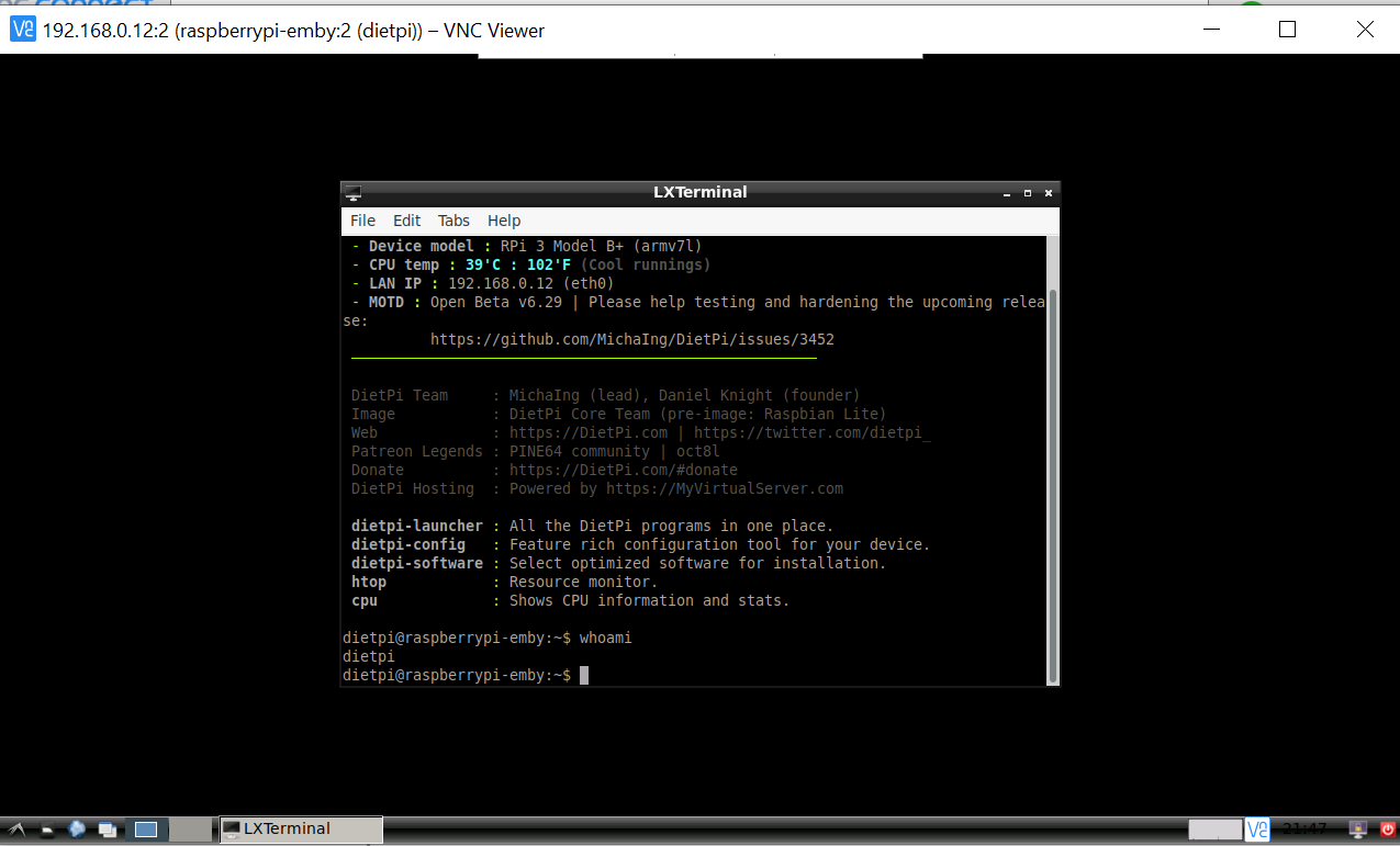

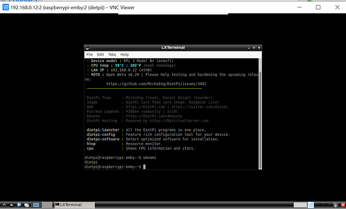

you see, user root is running usr/bin/vncserver :1 while user dietpi us running /usr/bin/vncserver :2
and finally you can connect to user dietpi environment by using yourIP:2 on RealVNC client. see attached
