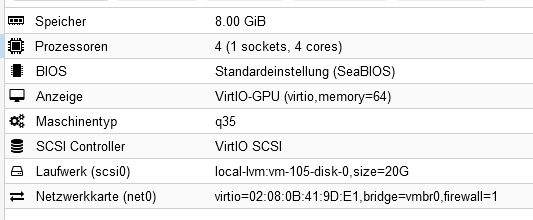

Hi @free_play, could we check your network settings in the hardware tab of the Proxmox VM?
I am running several DietPi VMs and have no problems since months.
I am using the virtio network card (instead of Intel E1000 or others), VirtIO SCSI (instead of IDE) and the q35 machine type (instead of i440fx).

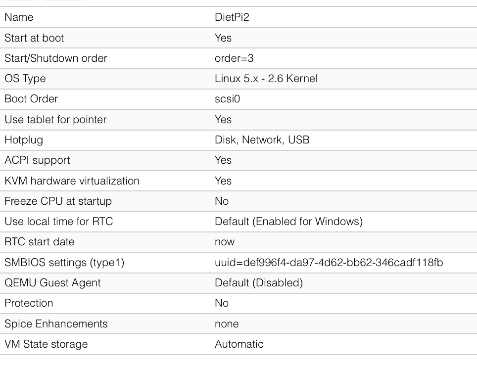

Hi @ StephanStS
Here is the hardware tab:
Your other screens are ones that I recognize from initializing the VM, but I don’t know how to view them again on a running VM.

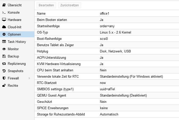

You can look in the “Options” tab.
The differences, I see, are
  • CD Drive: You have an additional CD drive: Should not make any difference
  • Hard disk: You have zfs file system instead of lvm: Should not make any difference
  • Network: You have the firewall disabled: Could make a difference. To change this:
