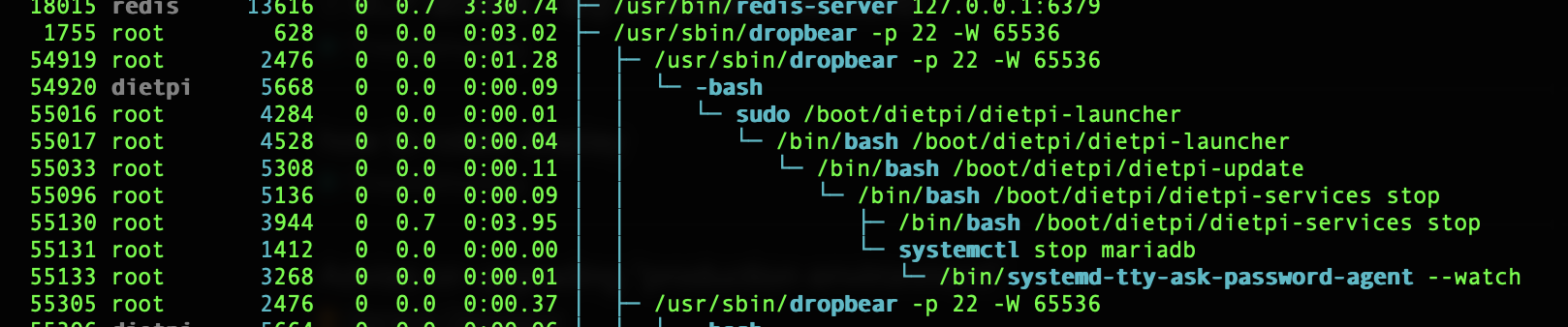

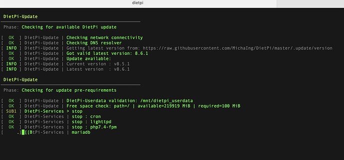

  • Update procedure stuck for at stopping mariadb for 30 min and showed mariadb failed after the update
First of all, it is not needed to do screen prints, you could copy everything from SSH terminal directly. :wink:
Did the update finished? Did you tried to reboot?

at least according your screen shot, it seems some part of MariaDB are still running. Therefore you are not able to start it again. You could try stopping the service and check log files
