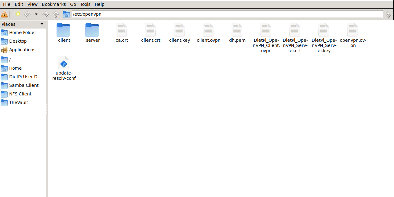

Looks like you should contact your VPN provider to check on all this depreciated option. I guess there you got the client config from.
While the cipher option seems to be wrong as well for modern OpenVPN versions, it is a warning only. The error is the same as for OP about the missing dedicated certificate and key files. Please see my last comment above about copying those into /etc/openvpn.
those files are in /etc/openvpn
EDIT: So i reimported the files over and it is now working fine now
