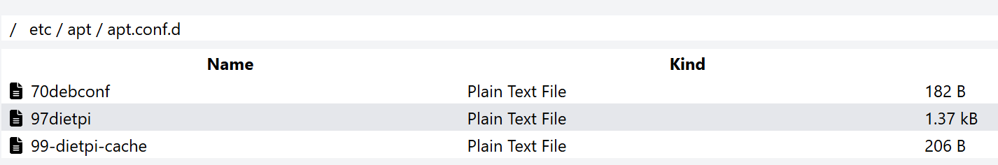

If I look at
/etc/apt/apt.conf.d
it only contains this:
Torben
