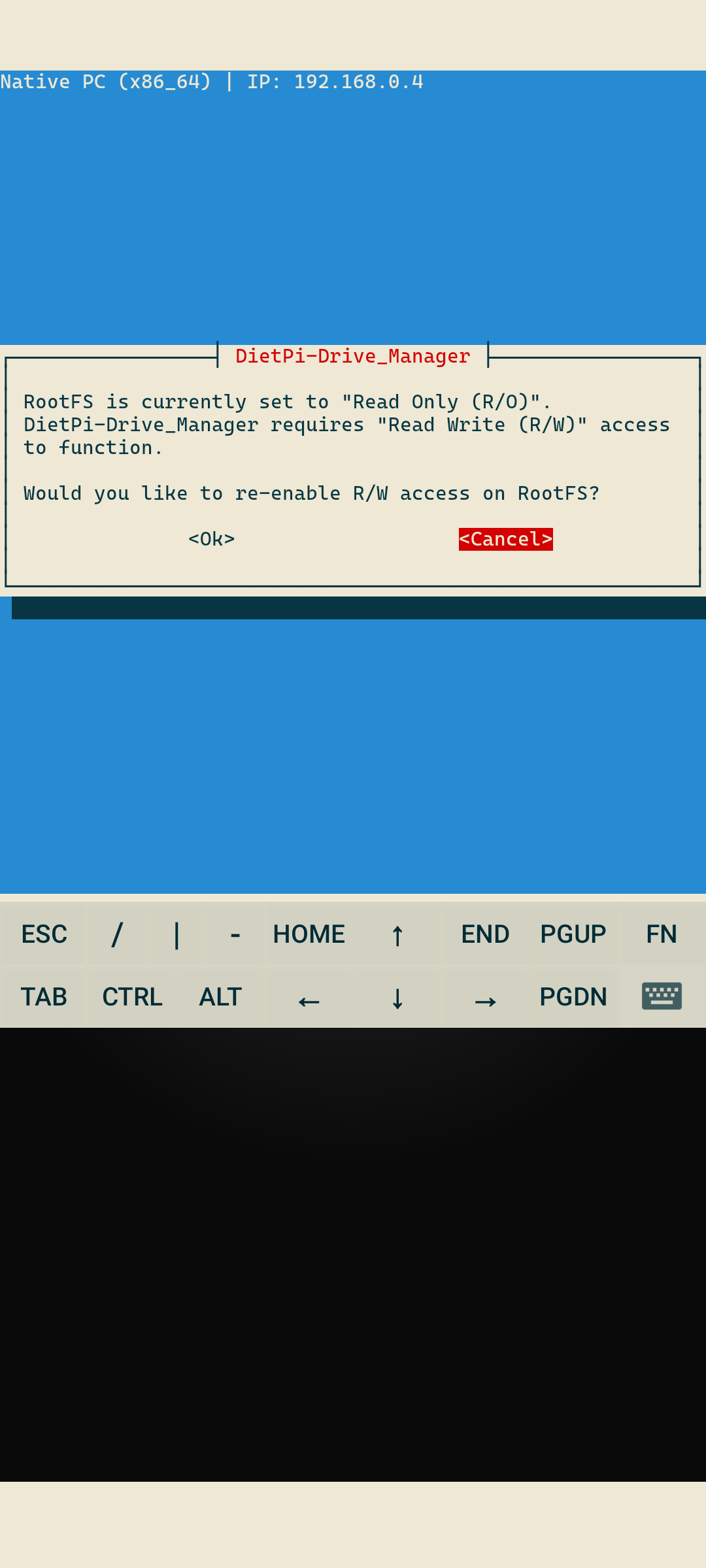

  1. … I ran sudo apt upgrade, in response to notice in Message of the Day.
  2. … Once update completed (no errors I could see), I issued a reboot.
  3. … Upon successful restart, no matter what command I issue, for example ‘sudo detpi-launcher’, I get a dialog that says "RootFS is currently set to “Read Only…etc.” . Screen shot of the dialog attached.
This exact thing happened the last time I did an ‘upgrade’, and in an effort to resolve it myself by hitting up google, I managed to make the situation much worse by, among other things, completely wiping out a 4TB drive with all my movies/shows//music on it. I didn’t want to make that mistake again, so I came here right away. (I had to re-install dietpi to recover the first time this happened)
I have also attached the output from ‘sudo journalctl’, issued immediately after NUC startup.

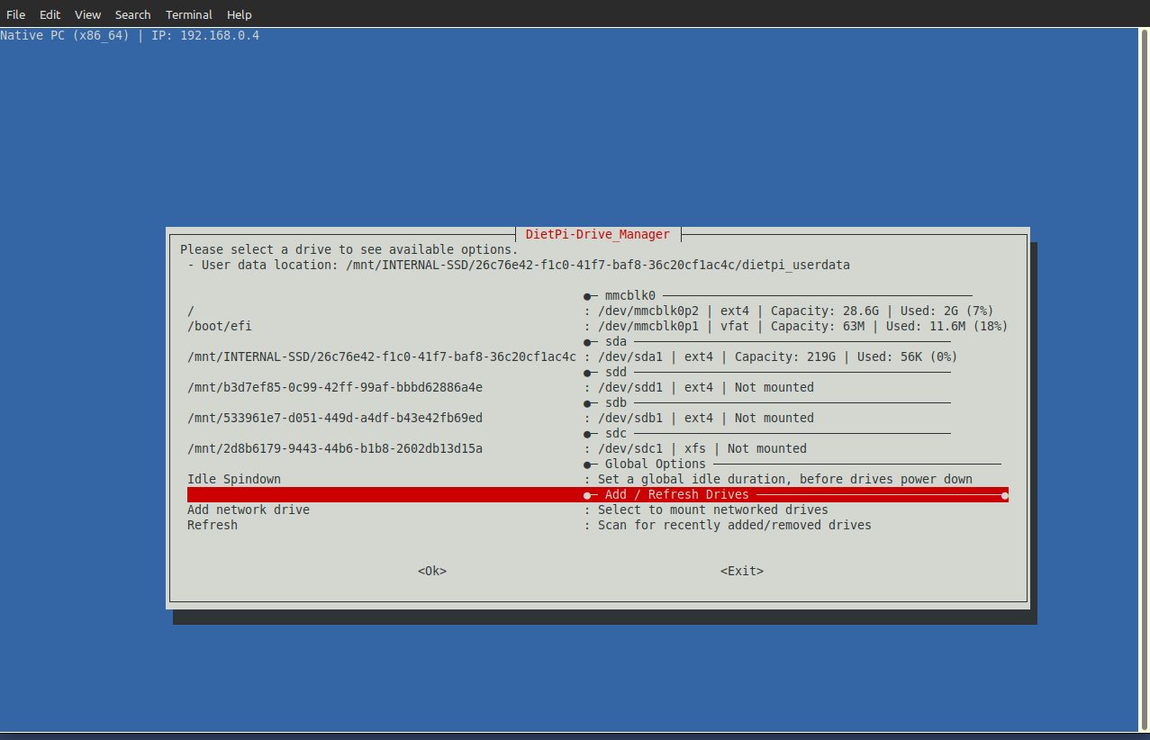

Does the message still appears when you run dietpi-drive_manager?
I plugged all three of my USB hard drives in, and ran:
sudo dietpi-drive_manager
It starts without error and lists my drives, but none of them are mounted to the folders they used to be. Screenshot attached.
