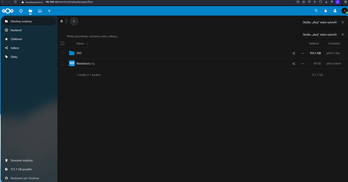

what is the exact error message if you try to create a new file/folder?
Folder cannot be created

-rw-r--r-- 1 www-data www-data     0 Oct  1 10:30 dietpi.test.file
interesting, the test file has been created, even if there was an error :thinking:

hmm this looks like your MariaDB software is broken / corrupted. Do you have a backup created before running the update process?
Unfortunately i don’t but that’s exactly how it stopped working and i thought a dietpi update would fix it
You have a problem with your local database environment and no update will fix this problem.
Let’s check following
mysql -e "SHOW DATABASES;"
mysql -e "SELECT db, host, user FROM mysql.db;"

ok let’s try to create a backup of your Nextcloud database
mysqldump nextcloud > "/mnt/dietpi_userdata/nextcloud_data/dietpi-nextcloud-database-backup.sql"
If all goes well, DB dump should be at /mnt/dietpi_userdata/nextcloud_data/
ls -la /mnt/dietpi_userdata/nextcloud_data/
root@DietPi:~# mysqldump nextcloud > "mysqldump nextcloud > "/mnt/dietpi_userdata/nextcloud_data/dietpi-nextcloud-database-backup.sql"dietpi-nextcloud-database-backup.sql"
-bash: mysqldump nextcloud > /mnt/dietpi_userdata/nextcloud_data/dietpi-nextcloud-database-backup.sqldietpi-nextcloud-database-backup.sql: No such file or directory
root@DietPi:~# ls -la /mnt/dietpi_userdata/nextcloud_data/
