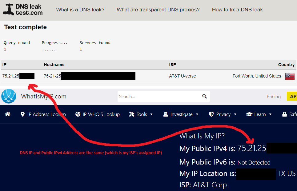

If I am understanding you correctly, then the attached image is showing everything correctly?
Yes this your own external IP address and not a DNS server. Basically the same address you would use to connect to your home network from external.

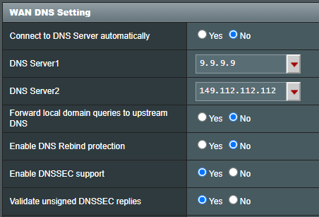

ASUS WAN DNS

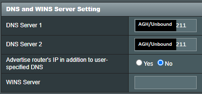

ASUS LAN DNS

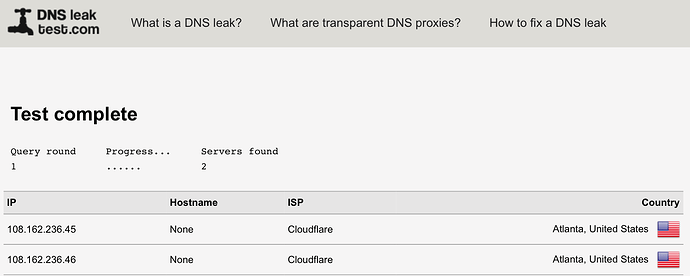

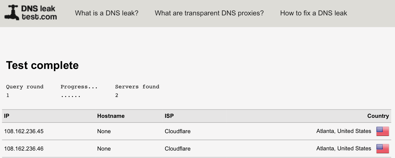

For example, I set my phone to use Cloudflares 1.1.1.1 (and turned off Wi-Fi so I am using Verizon’s LTE only) and I get this…
Settings in you router doesn’t matter as they are ignored by unbound. Better, unbound don’t care much on setting on your router. Unbound use whatever is defined on it’s configuration files. And Unbound is the one doing the DNS request towards the root DNS server. There is nobody in between. Therefore you are shown as DNS server :wink:
