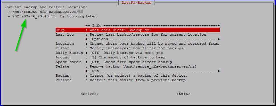

Yes, it should work with these steps (assuming your backup is on a USB device):
  1. Set up a new DietPi system with the smaller SSD
  2. Connect the USB device with your DietPi backup located on it to the new DietPi system
  3. Mount the USB device via dietpi-drive_manager
  4. Start dietpi-backup
  5. Set the location of the backup to the mounting point of the USB device
  6. If you set the location correctly, dietpi-backup reports the date of the last backup (on the USB device) in its header. If not, the backup location is not set correctly
  7. Start the Restore
