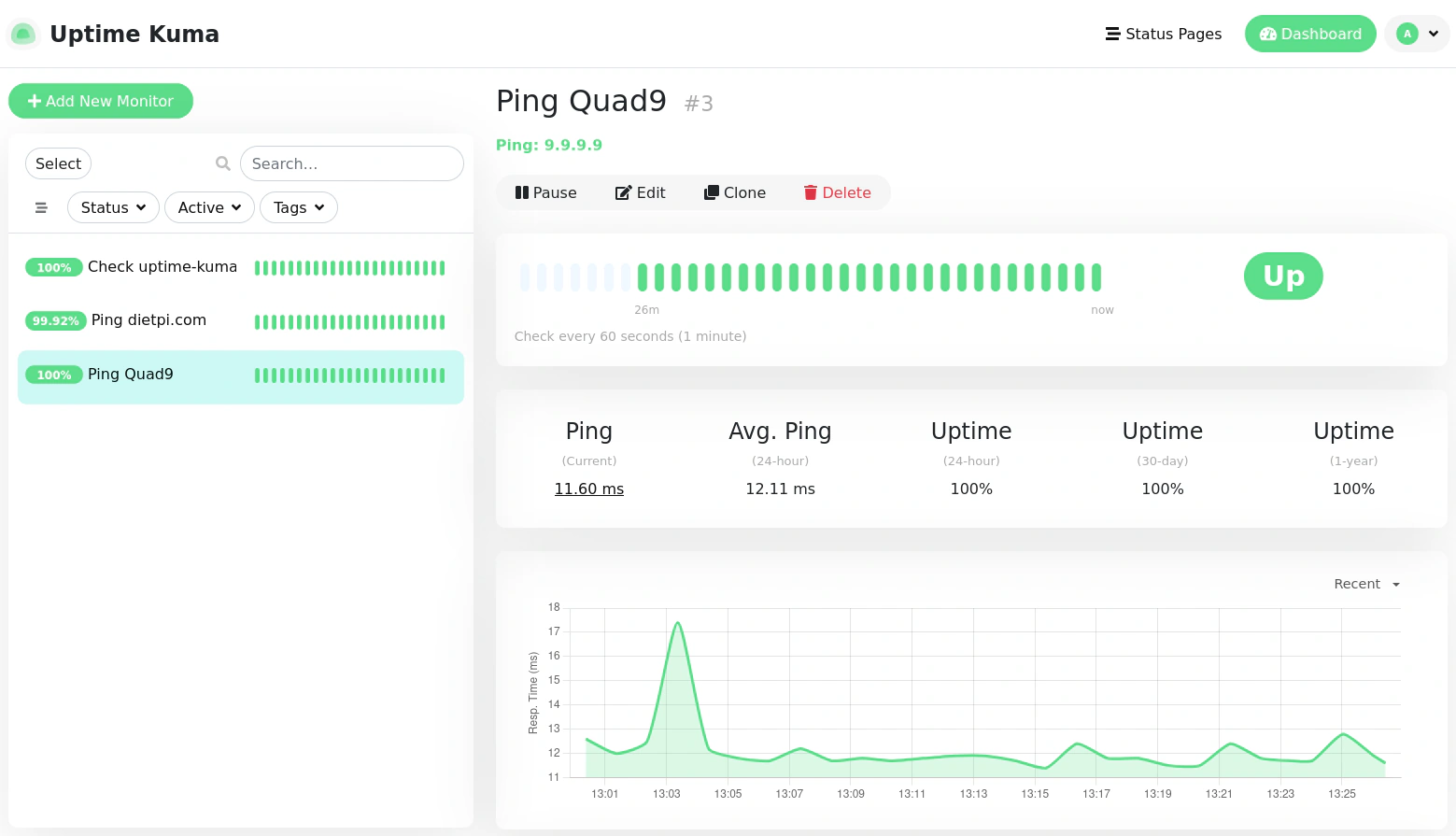

Uptime Kuma dashboard screenshot by @StephanStS
