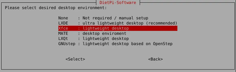

Desktop selection
This lets you enable a graphical desktop installation and to select the desktop (e.g. LXQt, MATE, XFCE). Choosing None initiates the removal of an installed desktop.
DietPi-Software desktop menu screenshot
Uninstall desktop via console (and not within a running graphical desktop)

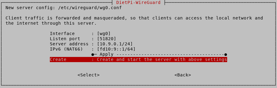

If no server exists yet, select Create server.
DietPi-WireGuard create server screenshot
The defaults are fine for most users. The server gets the name wg0 and uses the UDP port 51820. Its VPN IPv4 address is 10.9.0.1, and it gets a local IPv6 address fd10:9::1, if IPv6 is enabled on the host. When you select Create, the server starts. It also starts automatically after a reboot.
If your DietPi system is behind a router, forward the UDP port to it.
The main menu shows the server settings. You can change them directly:

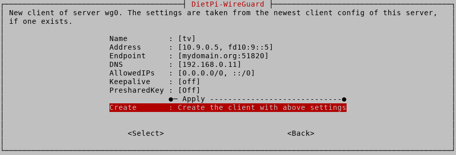

Select Add client and enter a name, e.g. the name of the device.
DietPi-WireGuard add client screenshot
The settings are fine for most users. You can change them if needed:
  • Address: The VPN address of the client. The next free address is used.
  • Endpoint: The address of your server on the Internet, followed by the port. Enter your domain name or public IP address here. For the first client, the public domain name from SOFTWARE_PUBLIC_DOMAIN_NAME in /boot/dietpi.txt is used by default, otherwise the hostname of your system.
  • DNS: The DNS server which the client uses while connected.
  • AllowedIPs: The traffic which goes through the VPN. Full tunnel sends everything through it. Server LAN only sends the traffic to your home network.
  • Keepalive: Keeps the connection open, e.g. when the client is behind a router. A common value is 25 seconds.
  • PresharedKey: An optional extra key for more security.
New clients use the settings of the newest client by default. This saves you time when you add several devices.

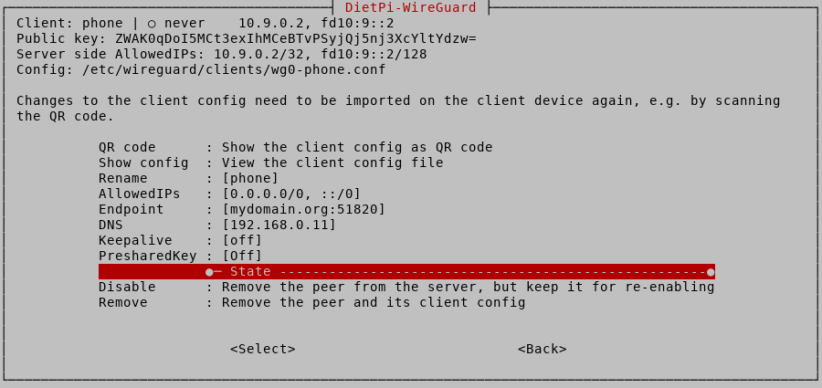

To manage a client, select it in the main menu. You can show its QR code and config, rename it, change its settings, disable, enable or remove it.
DietPi-WireGuard client menu screenshot
After you change a client, the device needs its new config. Scan the QR code again or copy the config file. The config files are stored in /etc/wireguard/clients/.

Everything in the menu is also available via command-line interface, e.g. for scripts. The commands only manage the config files. To see which clients are connected right now, use wg.
Create a client and show its QR code:
dietpi-wireguard add phone
dietpi-wireguard qr phone
Show all clients, and disable, enable or remove one:
dietpi-wireguard list
dietpi-wireguard disable phone
dietpi-wireguard enable phone
dietpi-wireguard remove phone
Change settings of a client or of the server:
dietpi-wireguard set phone dns=192.168.0.100
dietpi-wireguard server port=51821
Turn IPv6 for the VPN on or off:
dietpi-wireguard server ipv6=on
dietpi-wireguard server ipv6=off
Create a further server, and remove old key files:
dietpi-wireguard init wg1 port=51821 address=10.10.0.1/24
dietpi-wireguard cleanup
Here is an overview of all available commands:
Usage: dietpi-wireguard [<command>] [<options>]
Available commands:
    <empty>                         Open the interactive menu
    init [<interface>] [<key>=<value>...]
                                    Create a server config with defaults and start it, if no server config exists yet: port, address, ipv6
                                    The interface defaults to the first free wg0, wg1, ...
    list [<interface>]              List clients with address, state and config file
    add <name> [<options>]          Create a new client and add it as peer to the server
    remove <name>                   Remove a client: its server peer and its client config, after confirmation
    disable <name>                  Disable a client: remove its server peer, but keep it for re-enabling
    enable <name>                   Enable a disabled client again
    qr <name>                       Print the client config as QR code, without comments
    rename <name> <new name>        Rename a client config
    set <name> <key>=<value>...     Change client settings: dns, allowedips, endpoint, keepalive, psk=on|off
                                    An empty dns or keepalive value removes the setting.
    server [<interface>] <key>=<value>...
                                    Change server settings: port, address, ipv6
    cleanup                         Remove unused client configs and key files which are not needed anymore, after confirmation
Server address:
    address=<IPv4 address>/<prefix> The IPv4 address of the server, e.g. "10.9.0.1/24", whose subnet is used for the clients
                                    The CIDR netmask needs to be from 16 to 30.
    ipv6=on|off|<address>/<prefix>  The IPv6 (NAT66) address of this server, e.g. "fd10:9::1/64", "on" for the default fd10:<n>::1/64,
                                    whose subnet is used for the clients, with the same host part as their IPv4 address.
                                    Without it, clients cannot use IPv6 through the VPN, so that connections to IPv6 hosts hang until
                                    they fall back to IPv4, or fail. Defaults to "on" for new servers.
                                    "off" removes all IPv6 addresses and routes, also those which are not part of the NAT66 subnet.
                                    Changing the subnet and toggling IPv6 requires clients to import their config again.
Available options:
    -i <interface>                  Server interface, required only if more than one server config exists
    -y                              Do not ask for confirmation
    --ip <address>                  Client VPN IPv4 address, defaults to the next free one
    --dns <servers>                 Client DNS servers, comma-separated, empty for none
    --allowed-ips <networks>        Client AllowedIPs, comma-separated
    --endpoint <host>[:<port>]      Server endpoint for the client, port defaults to the server ListenPort
    --keepalive <seconds>           Client PersistentKeepalive, 0 for none
    --psk                           Add a PresharedKey
Defaults for "add" are taken from the newest client config of the same server.
<name> can also be the public key of a peer without local client config.
